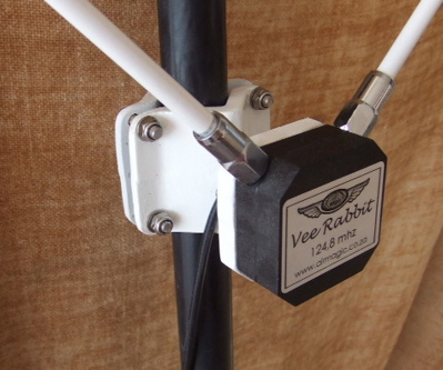

Delta VV, small update.
Thanks chaps for the comments, really, really appreciated especially after the original dark days of failures !!
Yes sir wireless..we are busy with them...as we plan to use in Cash in Transit applications as well as PPGs/Microlights.
However we have much larger problems to sort..At present Brian Eaton and I have been working with the GPS 296 problem (s) This repesents a far bigger problem to trikes and small aircraft and is not unique to this brand. Incidentally Garmin advised that they had "heard something" !
We have spent many hours with the "Buzz" that this unit gives out. Its not line created as it still happens with batteries, we have discovered its a Rf produced and is not sent to the intercom but the radio. We had placed rf beads on everything and eventiually discovered (today) that it enters via the trikes ground plane into the radio earth line via the coax.... now rf is a black art.
Both Brian and I consider that by using our King post Vee Rabbit dipole that we produce as a retro fit for the Airbornes antenna, accurately tuned VSWR to 124,8 mhz that it actually stops it.
As well as that we also eliminate power line induced noise collected by the radio (08 Ballito) when you fly over them which is a bonus. As its a dipole and mounted on the King Post its not grounded to the airframe.
Now we believe it may have fixed it, but problem number 2; Brian has a Solo Wings topless wing and no king post !! We will be mounting as the Beech Bonanza antenna on the keel.

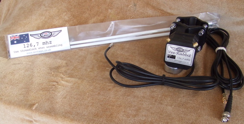

I attach a picture of the Vee Rabbit, some have already been sold to Australia. They are working very well and they help reduce rf ingress derived from the 5 watts tx from the Microair/Xcom.
Will keep the forum posted with our result on the topless wing installation and some pics. BUT we will beat it as its not going away, Garmin have just introduced the 496 and Lowrance are catching up. It seems that the goalposts are continually moving !!
Cheers Paul

When I fly over the Shell Ultra City by Midrand I pick up LOADS of static from - I assume the power lines? There's a cellphone tower there too? Altho in contradiction when I fly over the huge electical powerstation before Pinedene I get NO interference?
Generally I can hear over 150km away with few hassles. Any idea what I can do? It's VERY annoying as at that EXACT moment I'm normally in contact with Grand Central ATC and it's embarassing.

Hiya Diesel Fan, I have no guarantee that this will fix it in your installation however we have found that it really helps. Maybe worth a try ?? I may add that Rf is a black art, what works for one may not work for another. It sems there are no hard and fast rules?
I designed these for the Airborne Installation and never really intended to "advertise" here but send me a PM for details etc.

Diesel Fan, the Powerlines you talk about at Midrand is a concentration of 400kV lines connecting Appollo (near Rietvlei Dam) to Minerva (near Kyalami) run by Eishkom.
I am in the industry of power engineering for a day job and I can tell you that anything over 275kV emits serious corona discharge in the Mhz band (radio interference). What you are getting from your experience at Midrand is a bloody big radio signal from a huge antenna that will be hard to cancel out. This is largely a function of the voltage and current of the line and with a number of them concentrated in the same area, you are f@rting against thunder...
As an experiment to prove the point, when you are travelling by road, flip over to Radio 702 when you get to the area and listen as you get to the line of shortened lamps on the N1 where the lines cross the road. Let me know what you hear?
