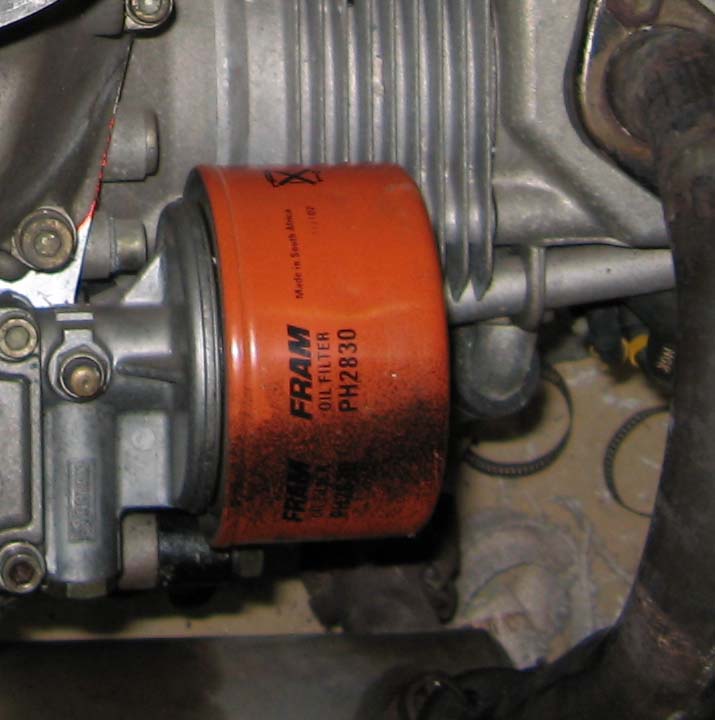

Postby Morph » Mon Feb 26, 2007 5:16 pm
Mogas,
Mine says, FRAM PH2830
Oil Filter.jpg (68.56 KiB) Viewed 1426 times

Postby Mogas » Mon Feb 26, 2007 6:56 pm
Excellent, thanks Morph.
I thought I had seen a fram on your engine pics.

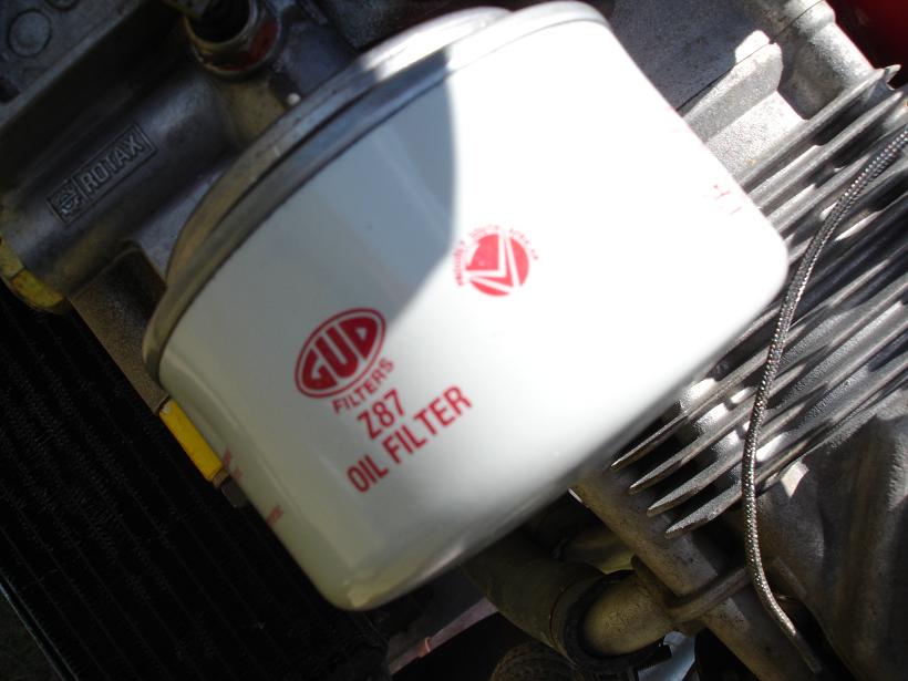

Postby CloudDancer » Tue Feb 27, 2007 11:23 am
GUD Z87 or Spirex SPX.O3054 :)
