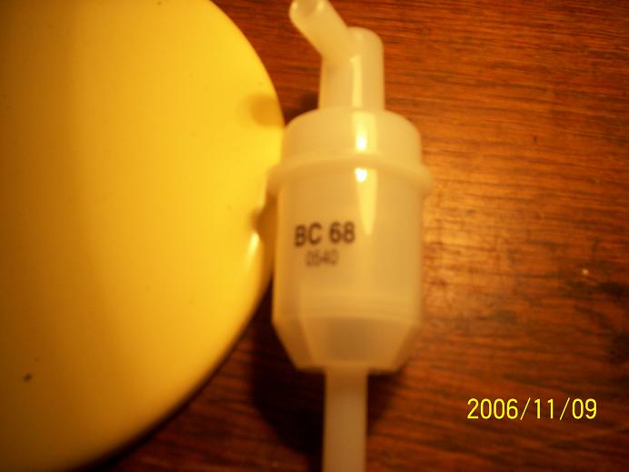

Hi guys we had a post a while back on this topic. The mercedez benz filter that whent out of production is still been manufactured by GUD it is called a BC 68 and looks and works exactly the same as the merc part. I have been using them for 3 years without even a cough. They are available from most autozone shops whil try and post a pic now.
- KFA
- Posts: 2789
Pic's
- filter.JPG (34.83 KiB) Viewed 2446 times
