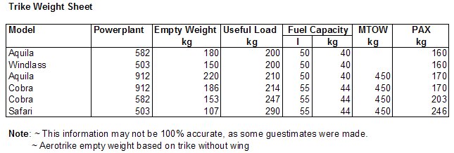

Hi everyone,
In preparation for my MPL I had to change my lifestyle somewhat to loose weight. I currently stand at 126 kg's, and have some way to go. I have been trying to figure out the allowable weight for a trike, and have come up with some interesting results. I had a look at the offerings of Aerotrike and Solo-Wings to come up with some basic figures to determine how the weighting comes together on a trike.
If I fly solo things should work out fine, but there might be weight restrictions for front seats and other weight & balance issues. I used a guestimate of 0,8 kg/l for the fuel, and the PAX column is my deduction of what the trike can carry, minus full fuel.
A 503 model seems to be able to carry more than a 582 or 912, so I am making the assumption that the powerplant has more to do with overcoming drag than with lifting weight? Furthermore, what is considered the maximum weight of pilot and pax on a trike? And last but not the least, what would be a realistic goal for my diet? :wink:
That will obviously depend on the weight of my instructor of course. But if I want to carry some self-loading cargo with me some day, what will be my limitations?
Any feedback, ideas and advice will be greatly appreciated.
Weight sheet, sorted by PAX weight

The only reason the 503 can carry more weight is because it is lighter than the 582. However more power gives you better climb. A 582 will give you much better climb.
Technically the plane can carry more weight than 450Kg but this will reduce the g rating on the plane. For example if the plane is rated at +6,-4 and you load it to 550kg then the plane will only be able to +4.9, -2.8 G.
A little 503 will struggle to lift this sort of weight.
But it must also be said you will be flying illegally if you are flying overweight and should anything happen your insurances, medical aids etc could have any issue with paying out.

Thanks for the feedback. What I am worried about is that my figures show that with say an Aquila 582 with full fuel will allow only 160kg's to be carried legally. Even if I get my weight down to 100kg's, I will only have 60kg spare, limiting me to softness and small farm animals. :roll:
And then I haven't even taking altitude or density altitude into account. It just does not paint a rosy picture at the moment. :twisted:

A lot depends on what equipment you use as well. Most trikers fit big tyres (they are quite a bit heavier than standard). You can use a C-gearbox and start your trike by pulling (good exercise too!) - you then save the battery weight. Electronic instruments are a lot lighter than analogue.......You also don't need to fill the tank to the brim. 582 uses 15 l/hr. If you want to take a heavy mate up for a flip only put in 25 to 30 liters of fuel an keep the flip to less than an hour.
As far as I know the Aquilla 582 is rated to 450kg MTOW? (Though their website states 200kg Payload. Does this exclude fuel?). Otherwise buy a Raptor - they are rated for 450kg MTOW.
Empty Raptor 171kg + Pilot 100 kg + Pax 100 kg + Fuel 50 l 40 kg = 411kg
This leaves 39 kg for coffee and rusks or a small furry farm animal. :wink:
