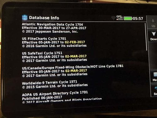

its a garmin Aera 660.

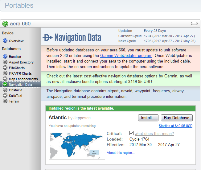

I loaded now Navigation Data - Atlantic .

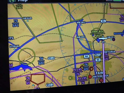

But for example there is no map suitable under:
IFR/VFR charts for SA. I see all the european countries, but it does not include SA.

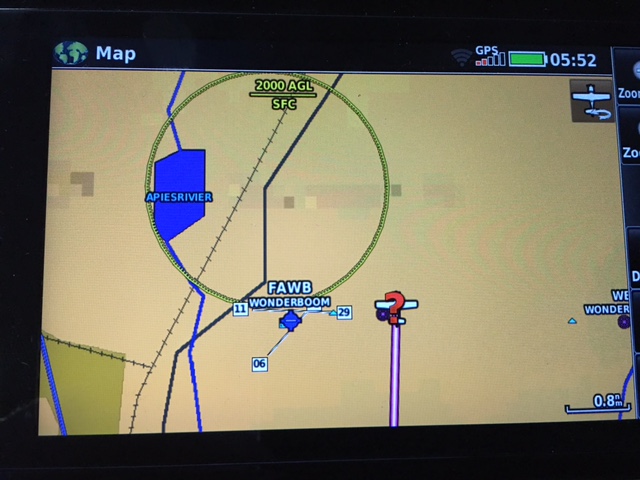

There are roads missing like the N1/N4

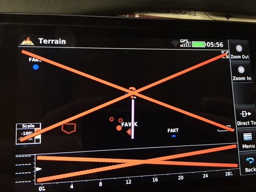

No terrain :(

or do i have to create some sort of "garmin South Africa Account" ?
i used https://fly.garmin.com/fly-garmin/portables/ to select the maps.

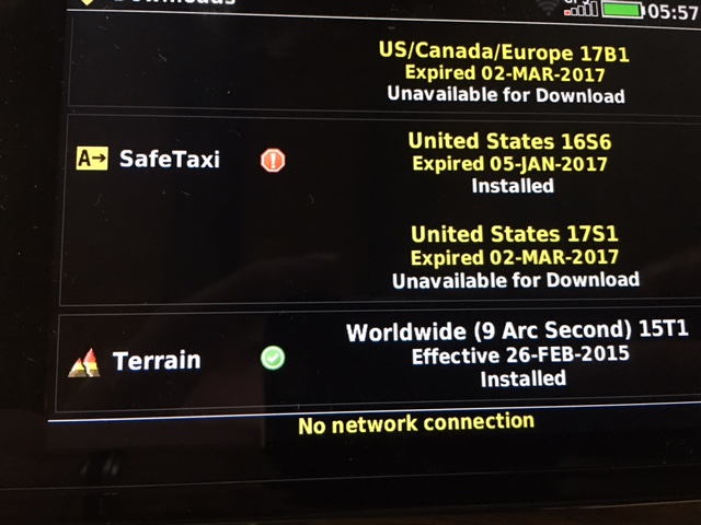

I think that you might have the USA basemap model
When you purchase a Garmin, you have 2 choices - USA or Atlantic basemap
If you have the USA one, other countries will have very limited information
It's not about where you bought it, but which basemap option you chose
As far as I know, It cannot be changed/updated :(

Yes, SoLo, that is precisely it. The USA base map is pre-loaded in the USA bought Garmin GPS's and cannot be changed. On later models, where ROM size was less restricted, the whole World Map was loaded as a base map. From your pictures it looks like you have one of the later models.
Unfortunately the Aviation GPS's can not accept/load Land Data. Only Aviation Data (and waypoints) can be loaded and updates must be purchased. Land Data is pre-loaded for the area it is sold in or, on later models, the whole World Map is loaded.
I must also add that the Land Data, base map pre-loaded on the units is terrible/inaccurate i.e. it is not a great loss to be without it. It is a free world map available with free MapSource, now Base Camp. I would not worry too much that it is absent or limited and would build waypoints to show important points of interest for you.
