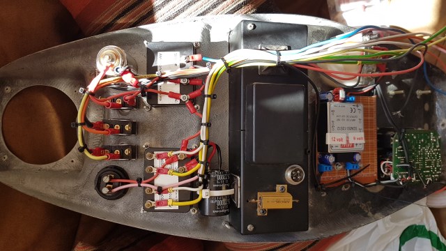

I use a 12vdc to 12vdc isolated switch mode power supply on the radio and a 12vdc to 9vdc swch mode psu also isolated on the intercom its a meanwell unit mounted on the veroboard, I hope this will help ?
