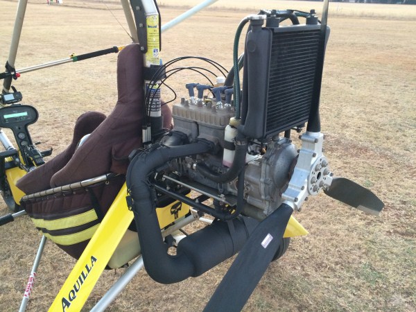

My exhaust was looking a bit dull, so I decided to do some maintenance..bought a can of Rust-Oleum High Heat, a wire brush and some masking tape.
Check out this link for info on Rust-Oleum: http://www.rustoleum.com/product-catalo ... /high-heat

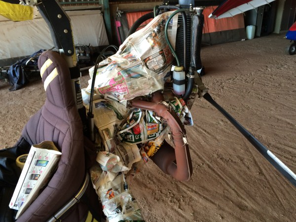

Closed up everything with a news paper that could get spray on beside the parts I wanted to spray...
Evenly sprayed the Rust-Oleum on the exhaust and my radiator...check it out ##
In total it cost me R150 and some elbow grease ##
Before
After

Het jy al gevlieg nadat dit gespray is?
Re: Exhaust
Postby Madman » Wed Jun 24, 2015 11:15 am
Ja, ek het al 5uur gevlieg en dit lyk nog die selfde...'n vriend het die goed koop no name brand bottle gekoop wat se heat resistance 350deg is en syne het begin af peel.Toe skraap hy die los stukkies af en spray dit oor met wat nog oor was in my kan en syne is nog steeds mooi soos myne.
