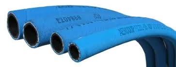

Try Aeroquip blue oil hose available at some hydraulic shops, I use it on the return line for the turbo on my KR2. I paid R275 per meter as its imported from the USA.

Found Parker High Temp Hose @ R200 p/m, will do the job. Used for Oil coolers.

Got a local manufacturer who supplied me with the correct pipe. Not cheap, still coming in at R200 per meter, but all good. They also supply oil coolers, radiators etc for our purposes. Shout if anyone needs more info.
Parker Push-Lok 836 Hi-Temp, Heat-Resistant Hose is designed for high temperature service. This hose is constructed of PKR elastomer tube, one textile braid reinforcement, and MSHA accepted blue synthetic rubber cover with embossed layline. Hose lines assemble in seconds without the need for clamps, bands, clips, or wires. This low pressure service hose is designed for use with:
Petroleum based hydraulic fluids and lubricating oils within a temperature range of -55ºF to +302ºF (-48ºC to +150ºC)
