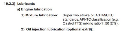

Postby D2O » Thu Mar 05, 2015 2:46 pm
RV12 wrote:
Jon Hewitt wrote:I have done 150 hours on my windlass 503 using Total super two stroke, advise from my instructor, I have had no problems at all.
I have just bought myself a kitfox 2 with the 582, please advise as too which oil is the best for the 582 and the 503 together, I don’t want to be using two different oils, could become a ball ache.
Rotax 582 watercooled = Castrol TC - W3 Super Outboard Plus @ R100 per litre.
viewtopic.php?f=13&t=15830&hilit=Castrol+TC+W3#p157187
viewtopic.php?f=13&t=14960&hilit=oil+for+rotax#p148171
From the Rotax manual:

Postby Dobbs » Tue Mar 10, 2015 4:05 pm
I do not agree (I am no expert) that if an oil is suitable for the higher temps of an aircooled engine, then it is fine for a water cooled engine.
Firstly, I am under the impression that a water cooled combustion chamber is hotter than an air cooled engine, it is just that with a water jacket around the chamber, the heat is easily dissipated, secondly, if an oil is designed to be suitable for say a hotter, water cooled engine, and is used in a "cooler" engine, it is possible that not all of the oil will be burnt, causing gumming up over time.
My first 503 went to 750 hours with no failure (tolerances were at max) and my second is at 350 hours, ALL of the time has been with chain saw oil - mostly Castrol
Bottom line, if it falls within Rotax's specs no problem.
