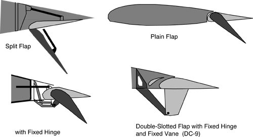

If I was going to build these flaps I would do it like this:
1) I would build the slats as part of the flaps – see the picture of the DC9 flaps below. The slats and flaps have a common hinge point, and there is no flap track.
Flap Hinge.gif (4.78 KiB) Viewed 4795 times
2) In order to get the benefit of the extra slot the flap deflection must be high – they probably have got to go down 60 or more degrees. This means that the hinge point has to be far below the wing – you are going to have to make completely new flap hinges and a new flap linkage. The force on the flap linkage will be a lot higher so you might need a longer Johnson bar or go to electric operation.
As far as building them from fiberglass is concerned you have two options.
The engineer will be able to give you the layup schedule.
1) Use a hot wire cut foam core. It’s really easy to make a hot wire cutter – just google it. You can only cut cores accurately up to about a meter long so you have to glue the cores together into the length you require – this is the way most of Burt Rutan’s home builts are made. You will need ribs and spars between the core sections anyway so this is not a big issue. After you have the cores and ribs / spars all made up, you glass the outside and then sand / fill / repeat until you get a decent surface finish.
2) Find a furniture shop that has a CNC router. Get them to rout a plug out of MDF. I would do two plugs – one for the top half and one for the bottom half both having a flat base. You then sand and finish the plug until it has a mirror finish and then lay up fiberglass moulds. When you have the moulds, you lay up the top and bottom skins in the moulds, glue the spars and ribs into one half, laminate all the joints and then glue the top skin onto the bottom skin. After gluing you generally have to reinforce the outside of the joint with more glass cloth. Although eliminating the cores makes the flaps lighter, there is a lot more work involved. You probably need to use honeycomb or Rohacell cores in the skins to get the weight savings anyway.
3) I think it would be fairly easy to make a jig to rout out the plugs yourself. I am thinking of a rail that the router can slide up and down on along the Z-axis. You need a frame that sides along the rail and is adjustable in the x and y axis. You then set up the router, take a cut, re-adjust, take another cut etc until done. The router will leave some slight steps, which have to be sanded out by hand.
Composites are not hard – just time consuming and messy. There is a huge amount of sanding and mess involved though and be prepared to make some scrap during the learning curve. I would estimate that you spend 10 hours sanding for every hour you spend laminating. AMT composites in Kempton Park have an excellent 1 day course on composite lay ups and vacuum bagging. They also give free advice. Don’t even think about working with epoxy resins unless you have an accurate digital scale that can measure to 0.1 gram. This is really important. If one batch of resin does not cure properly you end up scrapping the whole part.
