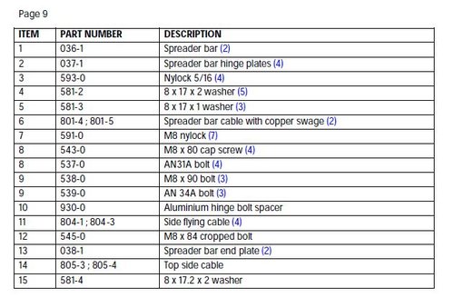

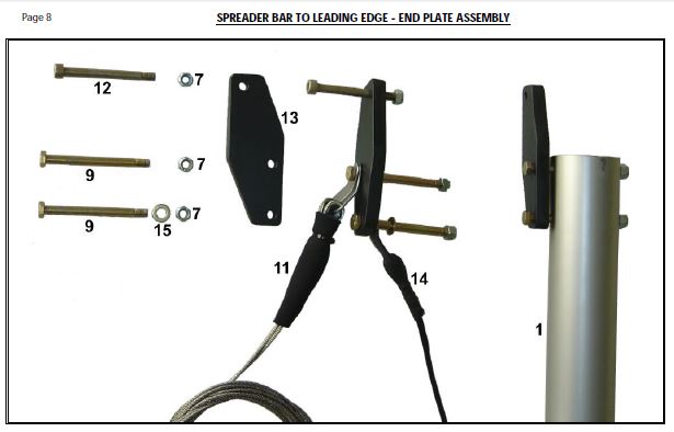

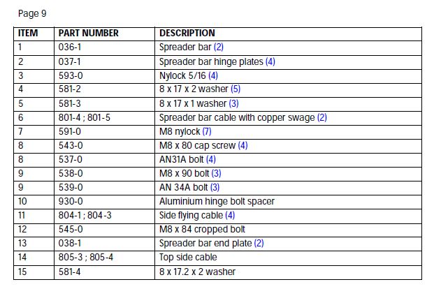

Again, I'm not having a go at any specific brand or manufacturer. In my case, I bought my trike new in December 1998 and sold it about a year after having my incident which was in 2005. On this forum, someone has kindly posted the Aquilla Wing Catalogue : https://www.google.co.za/url?sa=t&rct=j ... 7636,d.ZGU
dated 25/05/2005, which is post my trikes manufactured date and I'm please to see that the manufacturer changed the bolt in question (in my incident) to an AN grade bolt. See extract below:-
I'm pleased to see that from the parts list (Item 9 - part number 539-0) that trikes are now manufactured using an AN 34A Bolt (An aircraft grade bolt) and the second bolt that does not fasten the side flying cable uses a standard M8 x 90 bolt (Part 538-0)
There are many trikes of this brand manufactured prior to 2005 that might not have the AN grade bolt used in this strategic position. All I'm suggesting is that trike owners check what bolt is fitted and change it for an AN grade bolt and any others if it brings peace of mind.
In the context of the question asked by the person who started this thread, I feel justified in pushing the point that it might well be worthwhile in adding that extra element of safety, by ensuring that at least wing bolt failure is minimized through the use of AN grade bolts for the critical ones.
