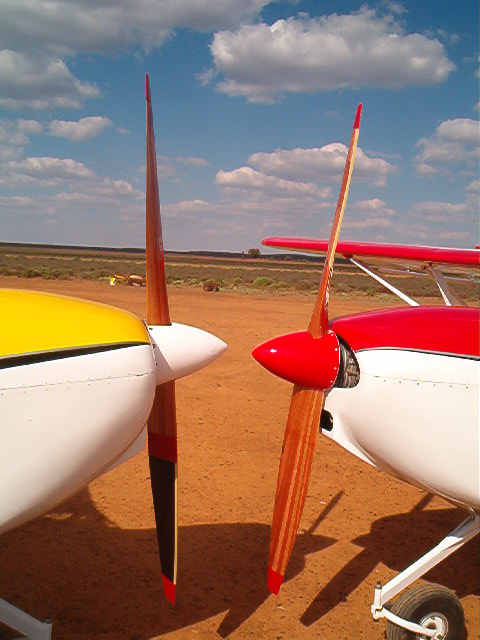

I need some advice as to what would the perfect prop to fit to a Safari with a rotax 912 ULS?
Should I go VP? Ground adjustable? I would prefer a 3 blade.

I have a ivo on my kitfox and wont go that root again
I want to fit a Airmaster VP prop but at +/-R70 000 and 12kg I dont think so
I think the Warp drive or a P-Prop is the way to go.
Oom Boet what do you think :?:
Goose
Re: What Prop to fit?
Postby Boet » Mon Apr 01, 2013 6:53 pm
Keep it simple and keep it light, The most expensive or the most "larney" looking is not always the best. Phone Oom Pieter de Necker on 27 11 7935235, and order yourself a 72" X 50" P-Prop, or, if you want to fly a little faster, go for the 72" X 52" cruise prop. You will never buy another prop!! (^^) (^^) (^^) (^^)
Weight is the enemy of performance, and complexity is the enemy of reliability!! As the chances for survival is proportional to the angle of arrival! vhpy

Does De Necker have a 3 blade or is it the 2 blade you referring to?
What's your opinion on the 3 blade 72" warp drive ?
Postby Boet » Tue Apr 02, 2013 2:41 am
If I had to choose, I would go for the 2 blade any day. Oom Piet`s props are just as smooth as the 3 blader, just a lot more effective, and then you can always trust a tree! vhpy

Thanks for the advise Gents, really keen on the de Necker, just want to run it by with Stephan (KFA).
Being based at the coast and wanting to use the Safari for medium distance cross countries, what would you fit? 72 x 50 or 72 x 52?
Thanks
Postby Boet » Tue Apr 02, 2013 9:42 pm
Verify with Oom Piet, but I would say the 72 X 52. The 912S is more than strong enough anyway........ vhpy

Postby John Boucher » Sun May 19, 2013 10:51 am
Value for money and effectiveness and moer of a strong and reliable, local expertise and great service - P-PROP
If you want to be different, pay much much more, have a composite, 3 blade etc.... http://www.whirlwindpropellers.com/ga/p ... otax3.html
I would go for this anytime before a Warp!
