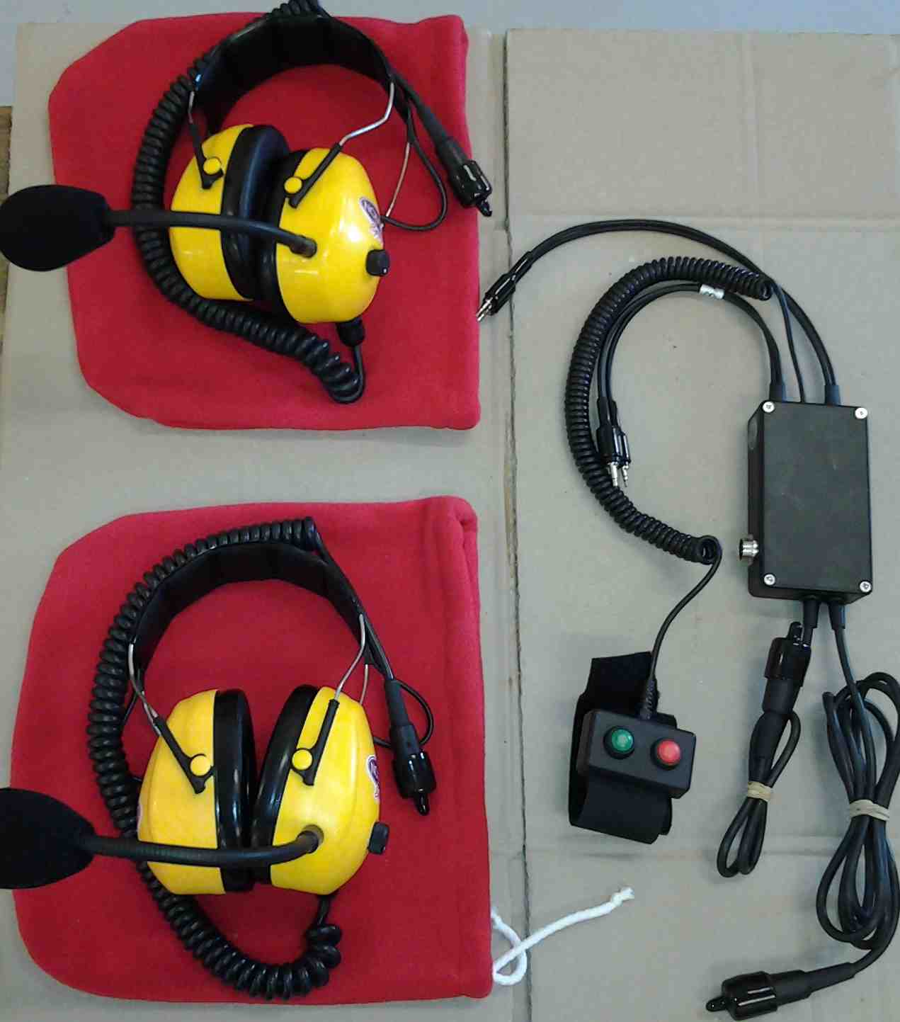

Hello Witkop, it is possible to buy a radio that will operate in the bands that you require, namely the Vertex standard VX7r series, however this will need opening up to achieve the 29nhz band and also the 136-174 mhz Vhf band commonly used. As part of our product range a device known as 4022 (named by the mountain rescue club after the A119 that crashed) allows two radios and 2 ptts with airband as priority. I am unaware of any other device that will perform this function. so the answers is yes we can do it however we will need specific requirements of frequencies and pre set channels. This may be used in a microlight as well as a vehicle. But they are not cheap and take us a age to make..price is dependent on the requirements.

Now we are getting somewhere, totally correct, you have two radios on the trike with two antennas, the ski boat antenna will be shorter than a air band antenna, either two vee rabbits or 1 vee rabbit and 1 whip to suit either frequency. The 4022 system has a air band priority so it will over ride the marine frequency with incoming transmission. The system has a full intercom, audio input as normal, two headsets with a ptt that has two buttons on the bar or panel. The second (marine or pmr radio) may also be configured to air band or any pmr band and frequency as required. We have done every radio to date, from Kenwood TK series, Taits, Motorola, IcomF303 series, VX150, HYT and even the low band radios. CB we wouldnt waste time with or the 466mhz band as they are toys. They are R7k a system ready to fly and a new marine hand held is probably around R2,5-3k.
