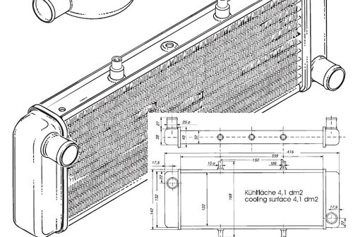

the 912 radiator is very small, because it only needs to cool the heads.
you can have someone make one up for you. I had mine made by Silverton Radiators, ended up being a tenth of the price. I attach the size and specification

Thanks for the help guys. I have the Rotax radiator as suggested by Morph, but I'm thinking it might not provide sufficient cooling in a pusher, especially since it isn't installed in outside air. I'm going for a VW radiator now with a core size of 380x320mm.
