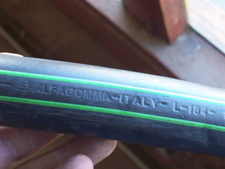

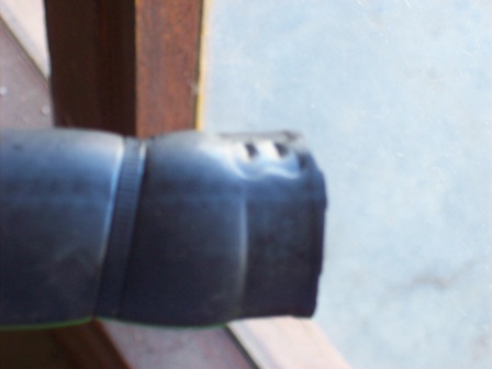

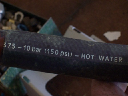

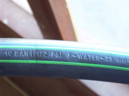

So I bought these larney-looking 25mm ID water pipes for my pride and joy. Had a nice sort of "feel" to the touch. (!!) So installed, checked clamps, filled up with coollant, checked clamps, fired up enjaain, ran it up to operating temps, switched of, re-tightened clamps etc etc ($$) ($$) ($$) ($$) . OK, so everything seemed hanky-dory to go aviating. First flight, on downwind had a LOT of green water and steam on the front screen. :shock: :shock: No problemo, reduced power and landed. Damn water pipe popped off, just underneath the expansion tank. Damn. When putting the pipe back, I noticed that something is not lekker with this pipe. (**) It felt like very soft silicone. Checked the rest, same. So I replaced all 25 mm pipes with a better quality from an automotive supplier. No more problems. When I had to "RE-TIGHTEN the clamps after the first engine run- I should have paid more attention. :oops: :oops:
Lesson learned: BEFORE installing ANY form of rubber hose in your aeroplane, TEST a sample of the dang thang.
1 Water-hose, 5 minutes into boiling water.
2 "Petrol hose": at least a week in a jar full of petrol.( Jep, had a problem there too!! "Petrol pipes" swelling up like jelly and the inside lining "dissolved!! :evil: :evil: )
If it does not emerge with "flying" colours, don`t use it. (Pun intended)
Fly safe
10 BAR - my ass.JPG (44.86 KiB) Viewed 690 times
Bloody liars!.JPG (39.86 KiB) Viewed 690 times
DON`t buy this shit.JPG (36.63 KiB) Viewed 690 times
notice deformation, even the cable tie did a number on it.JPG (39.09 KiB) Viewed 689 times

Postby Boet » Thu Jan 03, 2013 12:24 pm
Says: "Water pipe", but probably no good for hot water, it becomes like VERY soft silicone when hot, and, once cooled down, like hardish plastic. When new, unused, like a good quality rubber. No good, and it was bloody expensive!! :evil: :evil: :evil:
