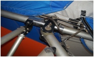

Hang block safety cable, hang block bolt, black spreader bar
cables, retention cord, king post & airfoil tube U bracket
Rigging and De-rigging the Aquila wing
- View of hang block
- image.jpg (25.44 KiB) Viewed 2455 times
