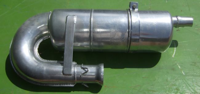

You need to gusset the exhaust as shown. This is the only thing that ever worked for me.

Thanks Boet for your offer. (^^) Except for the crack the exhaust is still in good condition. My AP inspected the wall thickneses and gave it the thumbs up. vhpy
The gusseting method realy makes sense. Wonder why Rotax does not do this standard....oh I suppose then they wont sell any spare parts. :evil: (**)

Just come back from Van De Graaf who welded the Gusset on for me. I am sure she won't crack again with the gusset in place. Thanks for the great advice. (^^) I will report if there is a problem. vhpy

Mine still going strong. I'm told the gusset dampens the harmonics which causes the cracking.
