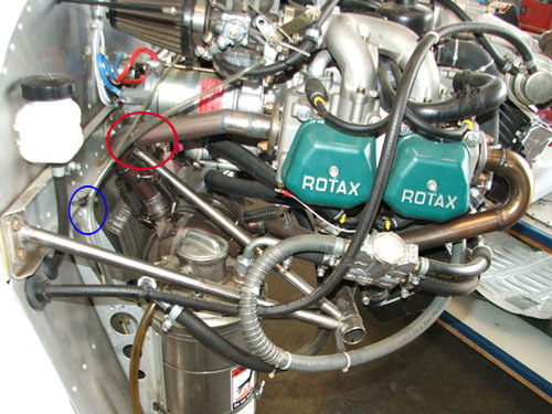

I thought I must ask you all to check your Rotax engine installation. I had a engine out in a Foxbat few month's back.
I was over the airfield doing a test flight when the engine started running ruff and died. Did a perfect landing. (Test flying is not for the fainthearted )
The carburetor vent pipe was rooted close to the exhaust system and the cable tie broke or melted I do not know. The pipe got to close to the exhaust and melted close. With the vent closed the carburetor started to vent trough the idle circuit and the main jet. The engine get's to mutch fuel and dies with fuel all over. I was lucky there was no fire.
THIS WAS NOT ONLY ON THIS FOXBAT. I have seen the wrong vent installation on some other Rotax installation.
The 912 must have a short vent pipe :!: :!: :!:
I have attached a photo of this Foxbat installation, I did not take a photo after the incident but I have marked the problem aria.
Please Check your vent, a small thing like this can bring u dawn!!!!!!!!
Fly Safe
Goose
Cable tie in blue

John Boucher wrote: I would however appreciate if anyone possibly has a photo of the engine of the new Aeroprakt A22 LS engine installation... anyone?
Hi John
This is a A22 LS engine installation that I have posted. The aircraft had +/- 55hr on when the owner had a oooooops on landing. The photo was taken before engine removal to replace the engine mount.
Goose
