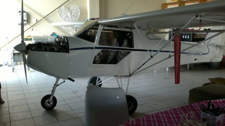

You can speak to me about the Vixen. It is not a Kitfox Vixen, but a Borian Vixen. Also made locally. It was a copy of the Bushbaby, therefore many of the components fitted.
