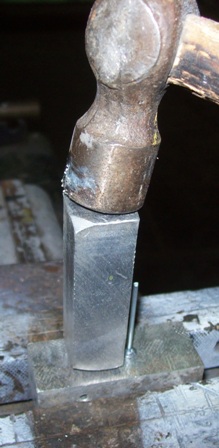

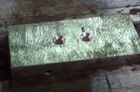

So you sit somewhere between nowhere and nothing, and you NEED countersink. Pop rivits. You live in a BEEG place, no warries, pop over to the harware store.........NOT SO. Not even all hardware stores keep them, and definately NOT the local Ko-op, or the Spar harware section. So what. Cape Town is 3 weeks on horseback away. Bugger this, I will make my own. This is wat I do.
This is the forming block
Aly block with 3.2mm holes and countersink.JPG (50.64 KiB) Viewed 1948 times

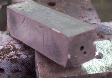

This is the one u use to hammer the ordinary dome head into a countersink
Hammering bloch, with 2,, hole drilled in..JPG (43.61 KiB) Viewed 1948 times
Da hammer
Moer it with a hammer......JPG (48.65 KiB) Viewed 1948 times
Voila! da problem solved. Countersink pop rivits!
Before on left, countersink on right..JPG (47.51 KiB) Viewed 1948 times

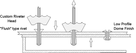

The exact opposite of Zenith aircraft... They use countersunk rivets, and then form the head into a dome when you pull them:
Apparently provides much stronger and more consistent seating.
