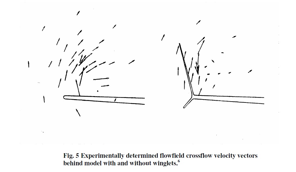

Postby Tailspin » Tue Mar 13, 2012 7:09 am
Really wanted to add a set of these to my Gemini wing but like you said 7K eish.
If we were looking in the region of maybe 2k then yes cool expensive but worth it.
The winglets increase lift and make the wing more efficient.
This was taken from http://www.mandhsoaring.com/Why%20Winglets/WL-IT.pdf http://www.smartcockpit.com/data/pdfs/f ... nology.pdf
Sorry I do not have R7000 for a set of winglets.
