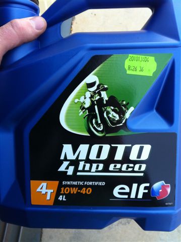

if you cant find any , you could use Elf oil , which they use for super bikes

The Shell advance AX-7 have not been approved by Rotax only the ELF oil “per Vanesh at Aviation engines.”

Just a friendly word of advice, be a little wary of 10W 40 oils at this time of year. 10W 40's tend to have a lower viscosity than the Advance VSX4 that most of us have been using. I would be very interested to see whats in the Elf oil, if anyone has a spare 50ml I would love to grab it for some testing.

I've just done a service on my 912 ul 80 horse with the new oil from comet. My CHT now run instead of between 90-100 at 115-120. Can the ELF oil be the cause? I was going to change the coolant but maybe try and get VSX and change back.

Dirk, The oil may very well be contributing to the increase in temps you are seeing. Most 10w 40's are thinner than the Advance 15W 50 that you have been using, I wont have a definitive result until we have a had a good look at the new ELF oil.
We will all probably notice an increase in temps due to the onset of summer and warmer days, hence the reason why oil choice and grade becomes important.

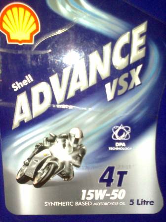

Managed to find one last bottle of Shell Advance VSX on the shelf at a motorcycle shop today. Everywhere else only stocking Shell Advanced AX-7 which I see is 15W-50 but the AX-7 label says that it's "synthetic based" not "semi-synthetic" like on the old VSX label. Does this mean the same thing or fully synthetic? I share T-Bird's concerns about not wanting to use it unless Rotax approved and my understanding has been that fully synthetic oil isn't a good idea if using AVGAS at all?
Both the ElF Moto Eco and Castrol Actevo X-tra are 10W 40 so the Shell Advanced AX-7 looks to be about the only 15W 50 viscosity option oil available?

the AX-7 label says that it's "synthetic based" not "semi-synthetic" like on the old VSX label. ]
Hi Learjet
I see on the VSX , it also says , Synthetic based .
According to the Shell suppliers i went to see here in the east rand , they confirmed that the AX-7 will be replacing the VSX , and i saw the spec sheets on the two oils , which confirmed that the AX-7 has a slightly higher spec than the VSX.

- Shell ADV.jpg (24.33 KiB) Viewed 3584 times
