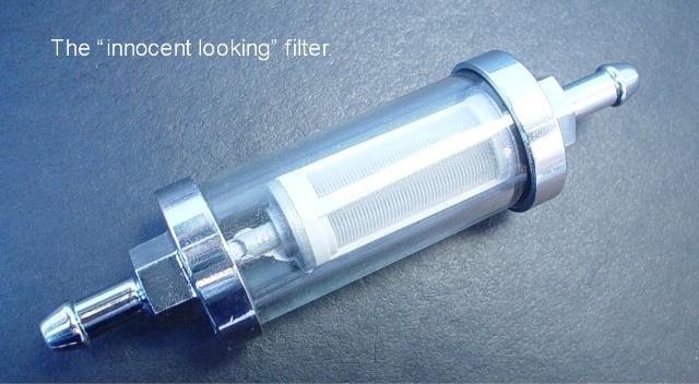

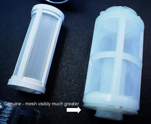

Postby John Young » Mon Oct 17, 2011 1:14 pm
Seen the movie too many times ... :shock:
