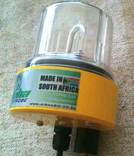

The base height may be reduced
Chaps,We have been making strobes for trikes for a while now, the Xenon is without question up until now a far brighter option, but its as Glen stated a directional thing and not actually a brightness thing. The Chrisnics are very good as they are scattered like a pineapple and use a driver. Hence the "Tick tick". On a trike with conventional Xenons the driver is in the base and the base is ally allowing a very efficient heat-sink for the mosfet. No problem except that they are large, not heavy. Glens idea is currently in use with helicopters, The Agusta 109/119 series has a Strobe the size and shape of a super size Mc Donalds coke cup, this is littered with smd Leds. Works well. Now we are busy with lighting solutions for townships dwellings, hence the interest in Leds generally and keeping up with whats happening. Drivers are a kind of a no ball in aviation due to interference. As an example, take a really good Petzel or similar headlight and place next to a radio and listen to the noise it makes. I have just imported a batch of 55,000mcd Leds, they have a 25 degree angle. These are useless for what I bought them for, but we have wired them up into a 1/2 pineapple shape and hitched up a simple 555 flasher circuit and the results are quite interesting. This may possibly be the solution by assembling them in a hex shape with approximately 9 Leds per side and another 18 on the top. It will fit in our existing lens but the base may be smaller...and lighter...

Hi Zulu1
The strobe in your pic is i presume self driven??
How much do they cost?
Mine i think packed up...still need to follow wireing.

Hi Graham, yes they are self propelled, the base is spun aluminum and has a rf bead inside it for noise. They are R950,00 ex works with trailing link bracket. We have stocks as we made this week.

Hi Zulu1
Where do I find the strobe you posted about?
