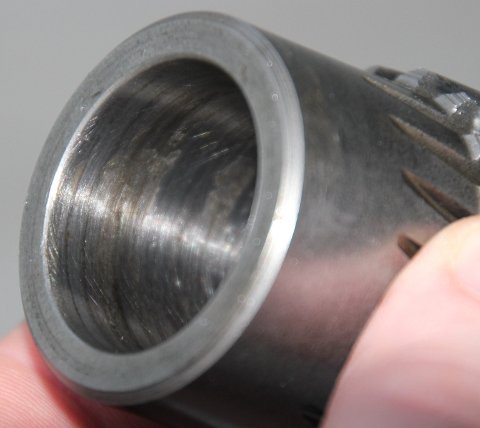

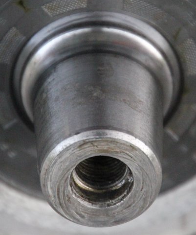

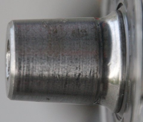

We put the gearbox back together. Attached some pics of the drive gears before applying emery paper. Tightened the locking bolt to 80 Nm now. Run the engine on the ground, but weather did not allow a flight test.
The ground test was inconclusive and there might another problem. The engine develops full 6500rpm and after a short while the revolutions fluctuate in the 6440-6520 range. Switching on the auxiliary fuel pump changes this to a 6500-6560rpm range. I'm not sure whether the unstable rpm is significant. However, the change indicates that I might have a slight fuel starvation problem too. I'm going to run tests with pump on and off and check the difference.
The knuckle joint assembly is the newer 12 spring washer configuration. There is absolutely no evidence for any unplanned movement on the joint itself. I think, in a pusher set up it is impossible for the joint to slip without any markings, noise and other evidence.

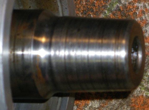

As a comparison, this is what the PTO looked after my incident. Even though the shaft is somewhat out of focus on the picture, evidence of the slipping can be seen clearly.
