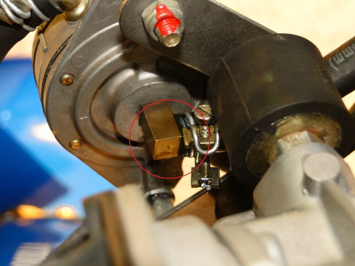

This morning I notice at the back of the “fuel pump” when I try to pull start there is petrol coming out of a small hole and this is squirted onto the battery, this is the first time I have seen this
Is this normal or should I be worried :?:

Can you guys confirm that on your fuel pump there is the same little hole as per my picture and if so I am tending to think that falcomp1 could be write in saying that when the engine is so flooded, fuel will be squirted out of that little hole
Also when the engine eventually started this morning no fuel was squirted out so I think that the pump diagram is still ok
The only other real concern is like Alkemac said this it is a BIG fire hazard (**)

That little hole is supposed to be there and its function, according to Rotax, is to purge the pump of fuel that could find its way into the pulse line that "feeds" the pump with vacuum from the engine case. If the pump is installed incorrectly then fuel from the crankcase can enter the pulse line and find its way to the pump. To prevent this, make sure the pump is installed higher than the pulse port. The other thing that can happen is if you "over-prime" the carbs, then the fuel will back-up into the line and find its way into the pump. It has nowhere else to go but out of the weep hole. Seems this was the case with yours.
Also ensure that the pulse line is no longer than 300mm from crankcase to fuel pump and that the correct type of fuel hose is used. Do not use crappy "el cheapo" fuel line here. Make sure it is relatively stiff with a decent wall thickness otherwise the vacuum from the crankcase will/can suck it closed with the result being fuel starvation and the pilot having to execute an unscheduled landing.
BTW, either move the fuel pump as explained or move that battery :shock:
