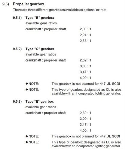

I constantly see talk about a b-box or e-box for a rotax engine. Can someone clarify for me what gearboxes are available, and the difference between them ?

Check attached pic for detail.

Correct me if I am wrong...but the B box is pull start and the C and E is electric start... :)

Postby Wargames » Thu Apr 14, 2011 12:08 pm
Madman wrote:Howdy,
s023
Negative,
Only the E box is "E"lectric start.
C and E boxes is a lot stronger than the B box in terms of inertia and loading that they can take.

Thanx Wargames.
Wargames wrote:Negative,
Then clears that question also up - two gearboxes - same ratios. !!!!
