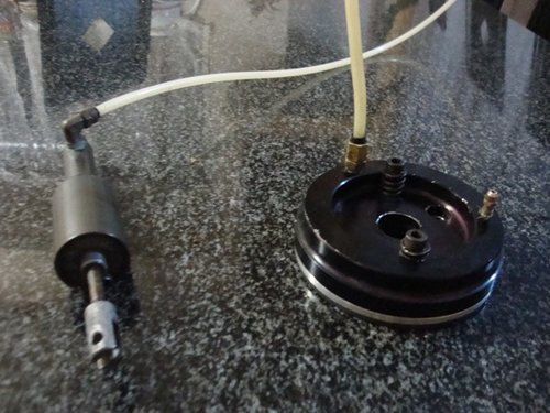

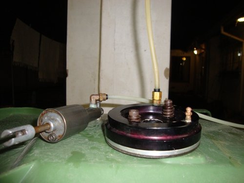

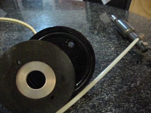

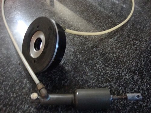

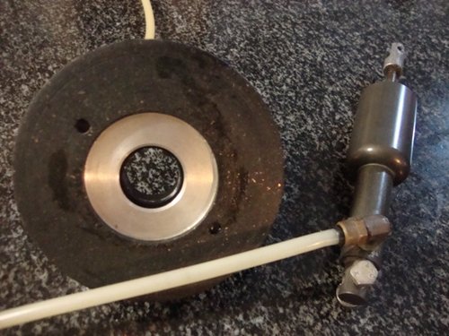

Hi Friends.My Plane Came With This Hydraulics Brakes Fitted,Its A Pioneer FlightStar.Can You Help me And Tell me If These Brakes are Reliable and What Oil Or Fluid Can I Use On These..Because I Try With brake Fluid And It is leaking All over..Any Information please, I'll appreciate it. Thanks

The correct fluid would have been Aeroshell fluid 4 or ordinary car ATF (automatic gearbox oil)
I am sorry to say that if you have put car brake fluid in there you will have to replace all the O rings and seals.
