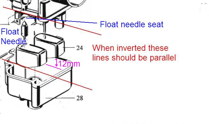

If this is not set properly, the float needle will not press hard enough against the float needle seat and the fuel will fill the float bowls and overflow through the vent tubes. Alternatively the fuel level will be too low in the bowls leading to fuel starvation
Adjust by bending the part that activates the float needle valve. If you bend this little plate up (when the carb is upright) the float needle will meet the seat sooner and the fuel level will be lower in the float bowl. If you bend this down the fuel level will be higher
Float Needle adjustment.JPG (7.84 KiB) Viewed 4401 times

Postby Alpha » Mon Mar 14, 2011 7:49 am
Hi Greg,
Once again I say thank you, I will give it a try. I will also replace the floats as I am sure the current floast are taking strain. I will let you know the outcome.

I did what Morph suggested and it seems to have worked! I made the adjustments, started the engine and warmed it up for 2 minutes, i then run the engine to 4500 rpm for 2 minutes and then back to idle for 1 minute, shut it down and checked the bowls and.... Fuel level is ok. Have not flown yet as the weather is really k@k!!! So we will test on Saturday, but all things look good!
