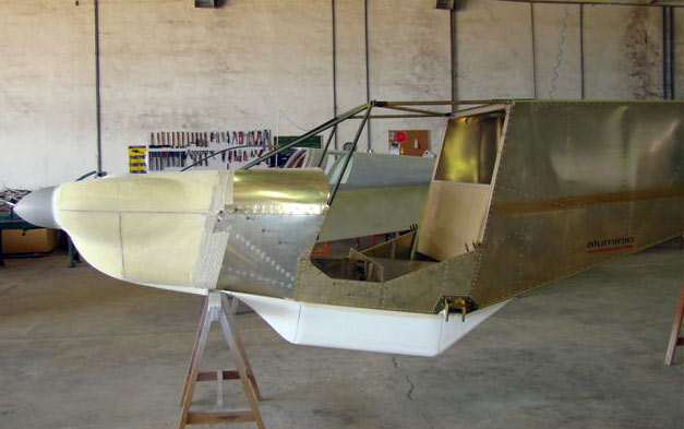

I would like to add exstra storage to my little aerie and am considering either a belly pod or wing pods. I've done some prelim designs and will still do all of the require due dilligence etc etc.
Accordingly the design part I'm fairly comfortable with, the part that I'm not is the legal requirements?
Am I allowed to add a storage pod to my plane?
In the event of any incidents, will this now default my insurance? Or similarly, will I have problems with the aviation authorities?

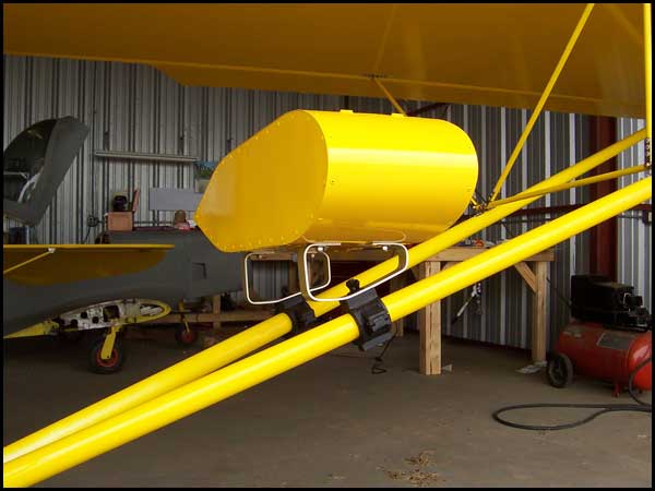

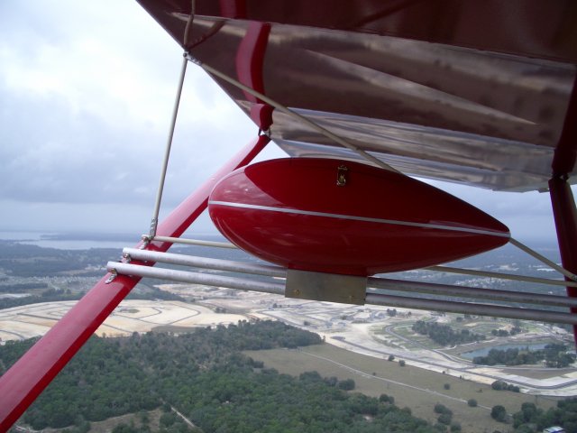

It would be best to contact engineering dept at CAA but I can tell you now that the type of attachements you are talking about will require drawings, engineering analysys and most probably some sort of a static test to put their minds at rest that your torpudo will not dislodge in flight and kill someone or that the plane might suffer structural damage because of the weight acting on the stress points on the fuse that it was not designed for. I must also add that I would think 3 times before adding anything to the liftstruts. From the pic I can just imagine the additional forces that will be created by the drag and the weight of the attachment to the struts. The Belly pod is a better plan and might be worth investigating.
