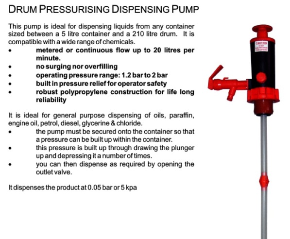

Bryanbryan wrote:Thanks guys I am ordering one of those red pumps George listed.They are slightly pricey at 732.00 but light and portable enough to keep in aircraft for fly aways. No effort then and can be stored in space behind seat!
Bryan
ZU BFR
ZU EZA
Is this the pump you're referring to?
http://www.pumprite.co.za/chemical.pdf
The "Drum pressurising dispensing pump"?
At R732, sounds like a useful piece of kit!

Thats the ons . Being plastic,made for chemicals , small and non electric makes it ideal for keeping onboard and using it anywhere. A real bargan for my needs!!!!!!!!!!!!!

Thanks Bryan!bryan wrote:Thats the ons . Being plastic,made for chemicals , small and non electric makes it ideal for keeping onboard and using it anywhere. A real bargan for my needs!!!!!!!!!!!!!
Bryan
ZU BFR
ZU EZA
Sent them an email and hope to add it to my kit pretty soon!!

Hierdie is die een waarop ek afgekom het vir R855 (incl VAT).
