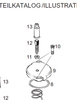

Potentially one if the two jet needles is sitting slightly lower than the other, resulting in a leaner mix on that carb and higher egt.
First determine which of the two piston are hotter. (refer to pic) loosen 11, and turn 12 out, retighten 11. This will lift that jet needle slightly. Start the engine and check. Keep doing this in very small increments until they are within 25 deg c of each
- Carb top.jpg (22.01 KiB) Viewed 1933 times
