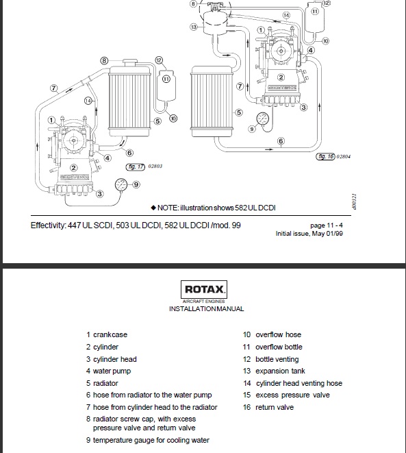

It is an inverted blue top engine and the engine is above the radiator, actually the radiator is across the center front of the engine, it is mounted up against below the gearbox and is higher than the cylinderhead but lower than the pump, a standard long thin rotax radiator
The water flow out of the cylinder head and into the bottom of the radiator on the cab side and exits at the top on the pump side,
If I look at the diagrams in the manual the flow is wrong but the airplane has 800 hours on like that so it is not wrong.

Replace the top resevour with a large bucket full of water. Flow should be bucket to radiator to water pump though engine and back to bucket. Keep the mags off so she doesn't start and use the starter motor/pullstart to crank the motor, check if there is water pumping though and out of the bottom of the engine. This will give you an idea if there is a blockage or not.

further updates.
I drained the engine completely, removed the radiator hose where it goes into the water pump, and efilled the header tank.
When the water came out of the radiator hose to indicate that everything except the block was filled there was till around 2 liters of water left in the bucket, this had to be equal to the volume in the barrels and block, it couldn't fill the block because the thermostat was closed, put the hose back on the pump and added the rest of the water, it took all the rest of the water so assume that the barrels had to be full to start with.
looking in the parts manual I saw there are 2 thermostats for the 582, one that is a 3 way valve for the blue top and a standard one, but the 3 way one is marked "thermostat 55 C degree" so I wondered if it must operate at 55 deg C
I had previously tested it to see if it was open at 80 deg but not 55
Popped it in some 55 deg water and it starts opening, at 60 deg it is wide open
Tomorrow I will blank off the bypass line completely, remove the thermostat, and run the engine up.
I would expect to see that the temps are all equal throughout the system, inlets around 58 to 60 deg and outlet around 10 deg higher maybe.(?)
If this isnt what happens the the only thing left is to remove the engine and strip it down.

Only WITHOUT the thermostat AND with the bypass blocked off.......or with the engine at operating temps and the thermostat fully OPEN..JohnCWE wrote:I also want to try the bucket idea of Morph's to see if I can measure the actual waterflow and then I should also be able to see if any bubbles are being created.
