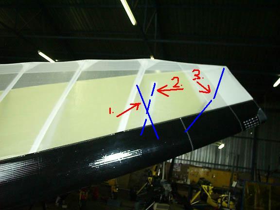

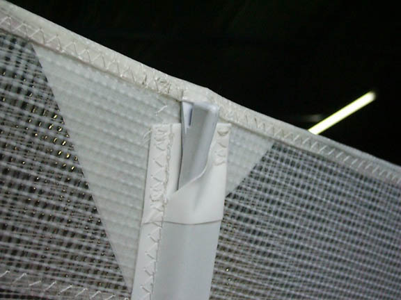

Spirit 15 doesn't have bungies, the battons have a string loaded tab that sits in a pocket. see pic, very clean design but the plastic sometimes gets stuck in the aliminum batton making them a mission to remove. I have a bunch of spares due to the amount of times they siezed.
Triker, I would compare the batton arrangement to the manual to make sure they are all in. I have attached a pic showing all the battons and struts in the wingtip 1) WASHOUT BATTON strut that inserts into a hole in the leading edge tube (just bearly visible through the sail), its a 10mm diameter tube. 2) Lower batton in white sleeve 3) Is the wingtip batton Again bearly visible, it hooks onto a pocket on the tip, and a stainless hook on the main spar, and has an overcentre lock to hold it in place.
Second pic shows batton positions in blue

Postby Triker » Thu Nov 18, 2010 2:59 pm
HI Biggles
The area surrounded by the red circle, is where I experience the flutter. Will your above mentioned explanation possibly affect that red circle area?
Also underneath the wing on both sides, there seems to be two identical small pockets (or socks) where something like an antenna wire or some kind of small batten can be inserted to straigthen or support that area(indicated by black dotted line). Is it perhaps possible, or is it just me.
