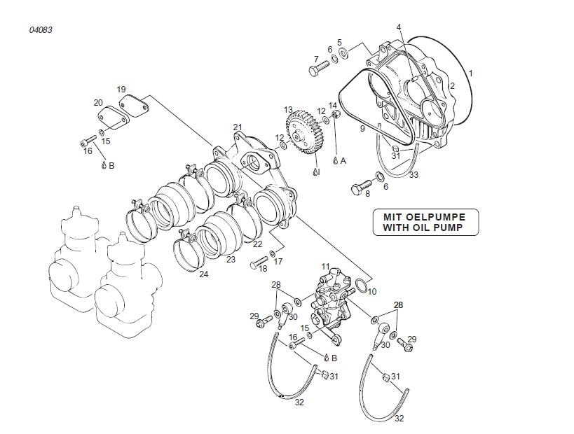

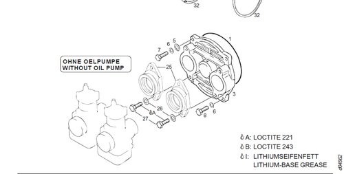

Hi guys
I bought a trike 2nd hand recently. The previous owner had disabled the autolube system by removing the gear inside the autolube pump and put it back on again(whole pump unit).
But I recently discovered that somewhere along to pump, there's a leak. Comet aviation suggested that I just need to put on a cover plate and gasket seal to complete remove the autolube system pump.
What I need to know is, what must I do with those hoses and pipes that run into the pump from the engine, and what must happen to the hoses and pipes that run from the pump back into the engine. In other words, what must me connected where?
Some photo's might realy help should any of you guys have.
Thanks alot for the help!
regards T
Re: 582 Autolube system and how to disable it
Postby Morph » Fri Nov 12, 2010 2:10 pm
I think he is reffering to removing 2 in the first pic and replacing it with 3 in the 2nd
you remove the whole pump assembly and pipes and revert the installation to the second pic

Postby Triker » Sun Nov 14, 2010 4:11 pm
Thanks Morph. The pics make it easy to understand.
