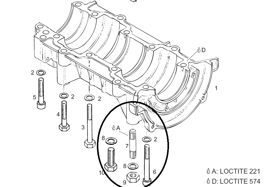

Hi Guys
Urgently need a schematic illustration of engine AND mounting of 503 on Aquilla with relevant torques of bolts and nuts especially the mounting points. Have just found cracked engine mounts with what appears to be evidence of overtightening of the mounting bolts. :x Scary stuff since all four holes had cracks and the last work was done by someone who was supposed to be qualified and an AP. ## Certain washers not even in place!!!!!!!!!!!!!!!

Postby Morph » Mon Nov 08, 2010 8:51 pm
M10 X 31/20 studs 10 Nm, 90 inch/lb
See pic, stud 7 with washer 8 and nut 9

Hi Morph
Thanks for promp reply. (^^) No big flat washer to spread loads? Or perhaps a flat strip of metal between left and right side?
Bryan
ZU BFR
Re: Torque on Rotax 503 bolts
Postby Morph » Tue Nov 09, 2010 9:58 am
Nope,
Installation manual does not make specific reference to requiring that
Specific reference is made to not overtighten the bolts, use the provided torque values
Postby Morph » Tue Nov 09, 2010 12:30 pm
I can email you the manuals if your mail box can take large sizes
typically 4MB but the illustrated parts manual is 8
I have the installation manual, operators manual, maintenance manual and Illustrated parts manual

Postby Ranger » Tue Nov 09, 2010 8:00 pm
Don't forget the loctite.
