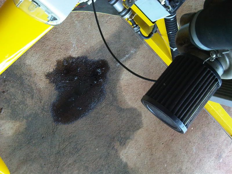

Hello Guys,
Today I went to fly my Magni Gyro and to my surprise I see oil in the floor exactly under the turbo of the Rotax 914.
Its look like the oil is dripping from the hose that goes from the turbo to the airbox. Also the air filter is completely wet in oil.
I turn the prop by hand several times an the engine is not hydrolock. I also does not started the engine since I want to know whats going on before I started it again.
Last time I use it was like a month ago and everything was ok.
Last time I change oil, Rotax filter and plugs was like 20 hours ago and I have not add any more oil so it not that I overfilled.
Thanks for your help and advices,
Isaac

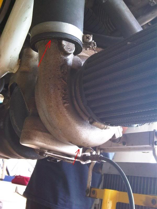

It could mean that the tubo seals have given in and you need to have the turbo serviced and the seals replaced.The seals keep the oil in the turbo to lube and cool the turbine shaft & turbo as a whole.Once these seals give in the oil leaks into the turbo and its what you have now.... oil all over the place.
Check if there is any oil coming out of the exhaust, thats a sure sign that the seals have given in.

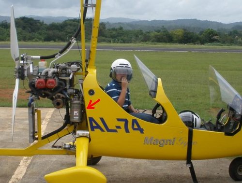

Postby Morph » Tue Oct 12, 2010 9:22 am
for oil to leak out there would mean the turbo is full of oil and overflowing out the top? :shock:
is the oil not perhaps coming from the rectagular box next to it, the oil sump. I would look at that o-ring, 22 first

Morph, thx for the pic. I am pretty sure the oil was coming from the hose that goes from the turbo to the air box, also the air filter was completely wet in oil.
I need to see when I have time again to go to my hangar :cry: I going to check it with a machanic and see what he find.

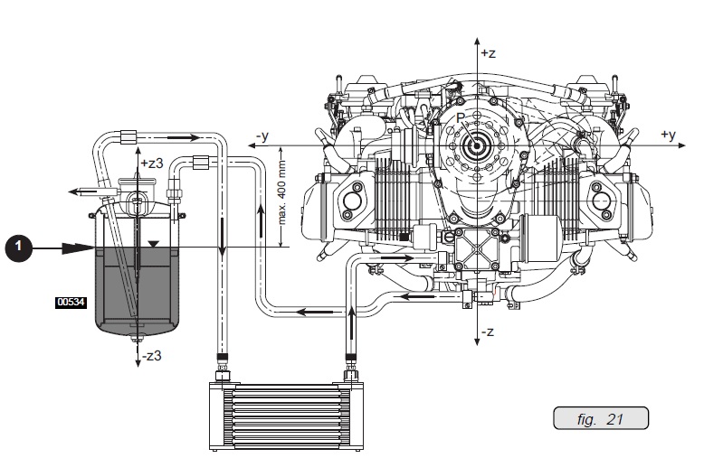

Postby Morph » Wed Oct 13, 2010 9:18 am
Where is the oil tank installed. If above the motor, gravity will move all the oil into the motor. I guess the oil will then push into the pistons from below and leak past the rings.
Rotax have following warning in the installation manual
Warrning: At higher location of the oil tank, oil might trickle through clearances at bearings into the crankcase during longer periods of engine stop.
The tank is supposed to be installed around the midpoint of the motor, see pic.

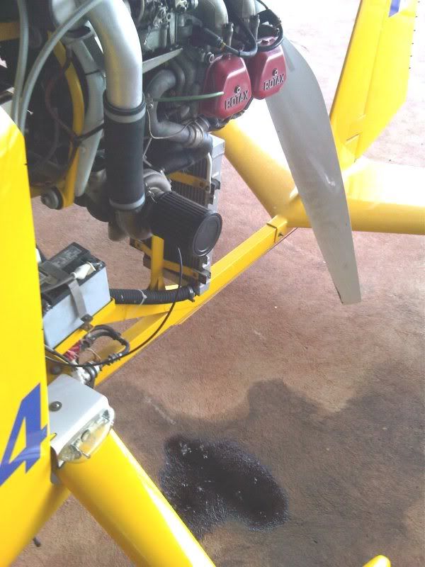

Postby Turbo_Boss » Thu Oct 14, 2010 3:16 am
Hello Guys,
On my Magni Gyro, the Oil Tank is installed under the engine so I dont think the problem was related to flooding by gravity. Please check the pic.

Stephan van Tonder
Posts: 1376
Re: Rotax 914 leaking oil thru air filter
Postby Stephan van Tonder » Tue Oct 19, 2010 2:53 pm
It is not impossible that it is an oil seal failure on the turbo's intake side. The oil is under more pressure than the air and will get pushed out there if the seal has failed/is leaking. The fact that you are only using positive boost during take off means nothing. The turbo is not static during any other time. It is still happily spinning away at between 80 and 150 Thousand RPM
