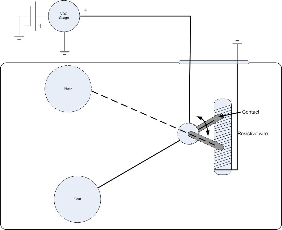

A simple float and gauge from Midas will work. Quite a few guys use them.
Make sure the float is big enough to for the size of the tank.
Cut a hole in the top of the tankbig enough so that the float can get through, but not too big that the whole unit falls though.
Us a cork washer, and self tapping screws.
Even though the "electrical" coil of the level is immersed in the fuel, there is not danger of sparks because it is measuring resitance, not voltage.
Additionally, make sure you flush the tank very well, to prevent crap from ending up in your filters and causing an engine out.

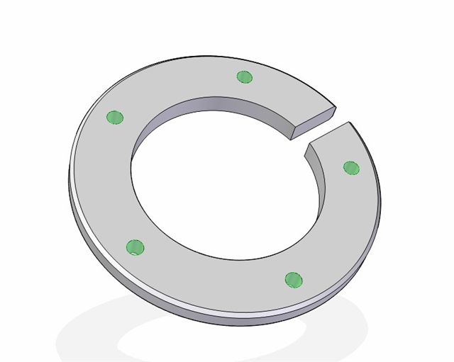

I'm not totally comfortable using self tapping screws to mount the float unit.
My one has a large aluminium washer inside the tank. A slot of about 8mm wide was cut out to form a "C" shape. The slot is a bit bigger than the thickness of the tank. The idea is that it is too big to fit throught the hole on the top of the tank, so it is slid through the cutout in the washer. Hard to describe ..... cut it out in paper and go figure.
It has five holes that were tapped, I think M5. If ou are going to make one, use 6082 T6 Aluminium, it is fairly hard, and can be tapped easily. This is a much more positive way of screwing the unit down.

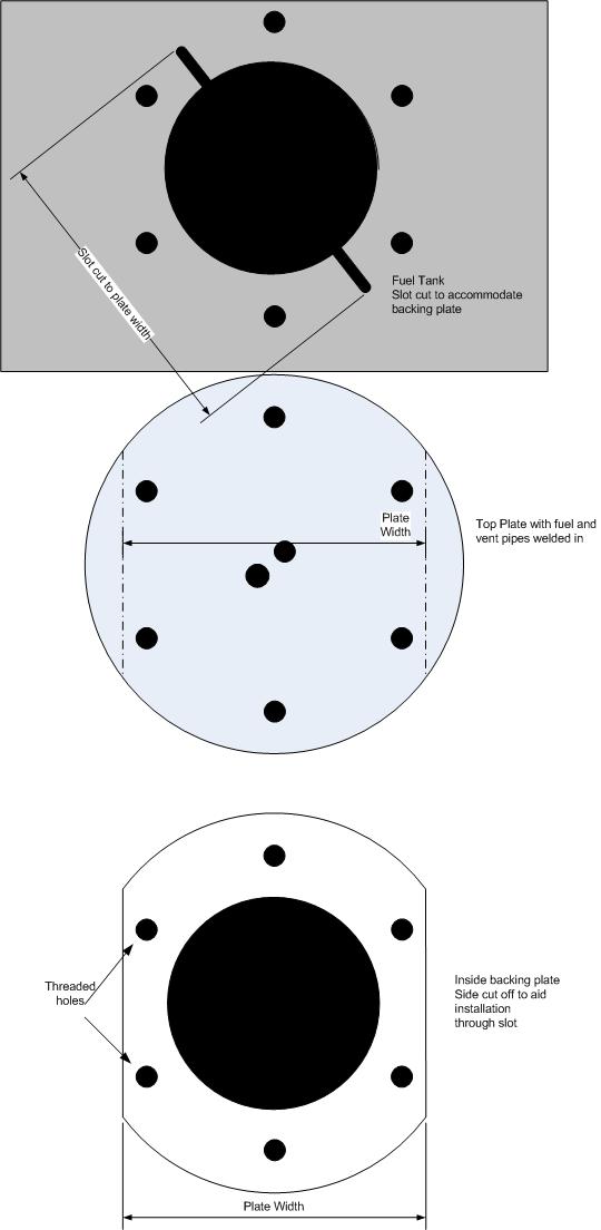

Postby Morph » Mon Oct 11, 2010 10:55 am
I agree a backing plate is much better
I worked on a design a while ago, also requires a slot to be cut

Postby bobthebuilder » Thu Oct 14, 2010 10:18 pm
This is the ring type thing that I tried to describe.
There is no need to cut the slot in the tank. This contraption fits on the inside of the tank.

Does work. My aqualla is done this way.
Byron Kirkland
