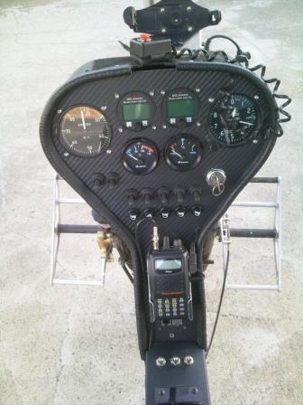

Postby Ranger » Mon Jun 07, 2010 5:52 pm
The face needs to become part of the structure for strength. Remove the face from an Aquilla pod and it becomes very floppy. Perspex is a no-no as it cracks and breaks very easily. The original face is thermoformed and is strong due to it becoming 3 dimensional having a lip. 2mm Aluminium is the best alternative when you take cost into consideration. It's strong and becomes lighter due to the cut-outs for instruments and it can be painted. If you have an unlimited budget then carbon fibre will do the trick just fine.
Instr. panel.jpg (34.16 KiB) Viewed 2230 times

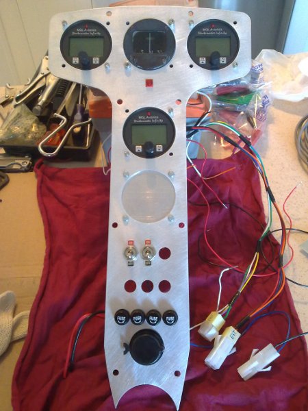

Re: Trike pod face plate material
Postby V » Tue Nov 23, 2010 9:27 am
Grumpy wrote:picture please vhpy vhpy
Got a bit more soldering to do still ...
Instrument panel work in progress

V wrote:I'm very impressed with the result, the cost and the help from their draughtsman who polished up my drawings.
Hi V
My dash is in need for some mods as well.
What was the total cost for plate, cutting etc. Did you pay for the plate per square used or did you have to buy a big piece and sit with the waste ??
ZU-CFW
Grumpy
Posts: 1819
Postby Grumpy » Tue Nov 23, 2010 11:18 am
Very nice V are you gonna paint it?? (^^)

Hi Low Level,
Low Level wrote: What was the total cost for plate, cutting etc. Did you pay for the plate per square used or did you have to buy a big piece and sit with the waste ??
Paid a few Rands short of R250.00. That included the assistance of the draughtsman, the material (3mm aluminium - for some reason they couldn't do 2mm) and the cutting. I just got the ready item, not off-cuts or waste. (I did 'liberate' a few pieces from their waste-bin to try the brushing on.) Am not sure how they worked out the price, but I was happy.
I used qcad (free) to make my drawings. It saves in .dxf format that can be loaded into AutoCAD and any other mainstream CAD application. The draughtsman was also happy that he didn't have to start from scratch.
Cheers,
V.
V
Posts: 293
Joined: Tue Oct 04, 2005 6:29 pm
Location: Diemerskraal, Paarl
Postby V » Tue Nov 23, 2010 2:18 pm
Grumpy wrote:Very nice V are you gonna paint it?? (^^)
Thanks. No, I brushed the surface. Painting aluminium is a pain (been there, done that on several Land Rovers :). Also my cut-outs are a very tight fit and a layer of paint would cause havoc.
Cheers,
