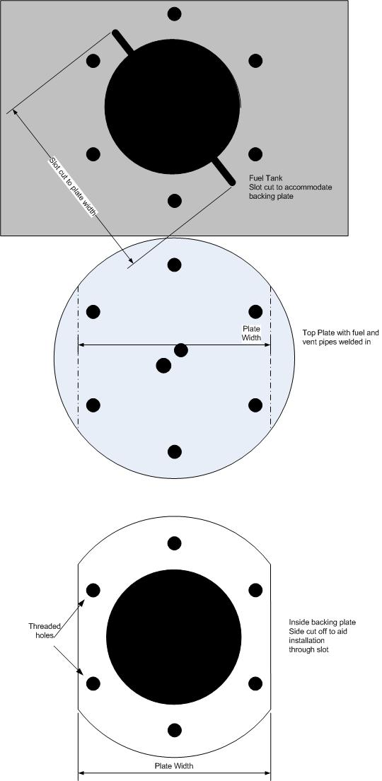

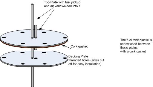

You need to sandwitch the plastic between two layers of aluminium with a layer of rubber/cork(preferably) between them. The top plate has the pickup tube and the vent tube(if neccessary) welded through it
Then you need a cork gasket, the same size and shape as the top plate
The bottom plate is designed to go into the tank and act as the other side of the clamping action. This plate has the holes threaded so you can thighten them up the squeeze the plastic and cork between them. In order to get this plate into the tank you need to shave two sides off the plate, and then cut a slot into the top of the tank to equal the size of this reduce plate width. Using wire or string to prevent the plate from falling into the bottom of the tank, insert it through the slot and then somehow retain it at the top of the tank (thread through the holes, tank upside down etc. Next the cork, then the top plate, and finaly the screws. Hopefully this is clear.
