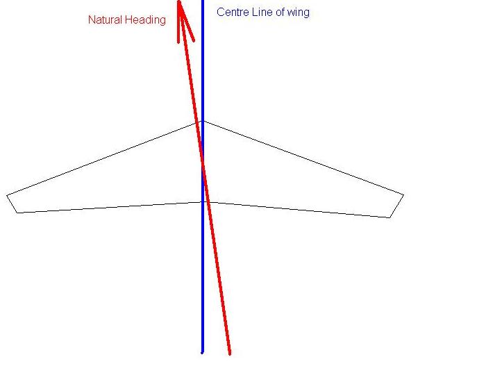

This makes sense. So if a wing has a natural slight yaw in straight and level flight due to a slighly bent batton or other differences the wing doesn't fly perfectly straight but you wont pick it up in normal flight. But with a fairing its like a slight crosswing on he side of the fairing causing the whole trike to bank.
So the remedy would be to get the wing to fly straight... check the wing is perfectly symetrical.

as a matter of interest how did you check this? I have been wondering if mine is flying straight. Theoretically without a fairing it will still fly straight and level, even if the wing is crabing slighly...
What keeps the wings straight it equal drag on both sides of teh wing. If you have slightly more drag on one side you can get slight yaw
