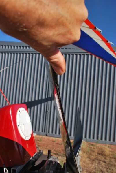

In WUO, the trike I fly (and bundubash) with near Aurora I have a NC Prop, which I have mended with Tippex and the like whenever the craters got too big. After this morning's flip, I discovered that the trailing edge has split open, and if I squeeze the prop it gives a nice crepitus (you will need to look this up).
So the short and the long if it is I want a new prop, for my upside down 503 - which prop?
The NC seems to brittle for the Sandveld's klippies.
I have a Warp on my other trike, also takes some hammering.
A De Necker Prop? Had one of those on my other trike but it got uhm damaged. Liked it.
Can a Warp be fitted with those metal strips?
Please help.
