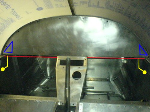

Here is the panel:
The red line shows (probably) the only convenient spot for a torque rod. (Actually a bit higher up - behind the lip of the panel. There is a gap around 11cm wide back to the fuel tank.)
The blue triangles show the open area of the panel, past the sides of the fuel tank. There is a very deep space here, but small. There are also two brackets directly beneath this space, making access to the torque rod difficult.
The yellow lines show an idea I am toying with - just putting control arms directly on the torque rod, coming out underneath the panel. The arc that the arm knob will move in is not great, but it can work.

I didn't realise it at first, but unlike the Zodiac, the Raven has a vertical channel running all the way, top to bottom in front of the firewall. And the engine comes to within 5cm of that channel. I just can't find a *(&^% gap big enough for a torque rod in front of the firewall, and stuff all behind the firewall.Boet wrote:Why do you not fit the torque-rod against the front of the f`wall? Fit 2 BB throttle assemblies. Should work beaudifull!
The only gap I can see of is just below the panel.
