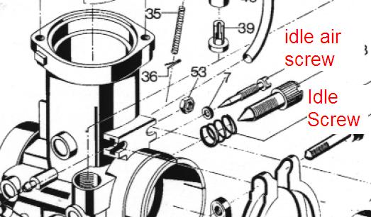

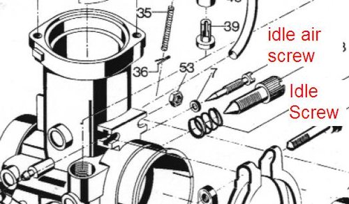

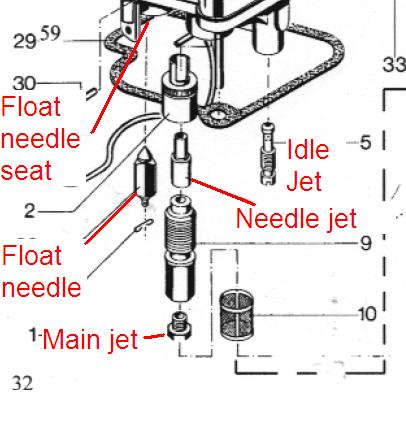

1. make sure the Idle jets are clean. Remove float bowl, remove idle jet and clean (see pic)
2. Turn the Idle air screw all the way in, then out 1.5 turns
3. Check that the two pistons are exactly the same height from the bottom when looking into the carbs from the front with the throttle fully closed. Insert two straws of welding rods and make sure they are at the same level. Use the Idle screw to adjust (The large screw). Warm up and set for about 2000rpm

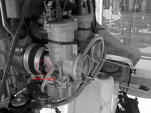

4. There is air leaking somewhere, check the rubber boot for cracks between the cab and the intake manifold , the rubber stopper on the side of the carb (see pic circled in red) or intake manifold gasket
