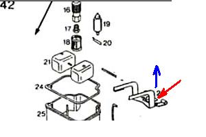

Fuel coming out of your one carb is as a result of the float level being set incorrectly and not closing the needle and seat.
Simple to fix, the float is not closing the needle and seat off properly
Bend this little tag (red arrow) slightly up (blue arrow). It presses needle 19 against the seat.
Start the plane, warm it up, run at 3/4 throttle for a while and shut off.
Take the bowls off carefully and remove the floats. The bowls should be filled up to about 12mm before the top
Alternatively replace the needles and seat.

- Bing 54 float level.JPG (8.67 KiB) Viewed 2723 times

Thanks Morph
I will check the float levels, etc, etc.
