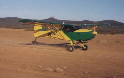

Postby Boet » Tue Jul 21, 2009 8:59 am
I installed one into a Bushbaby, and the performance was awesome. Would not mind to have one of my own!! vhpy
