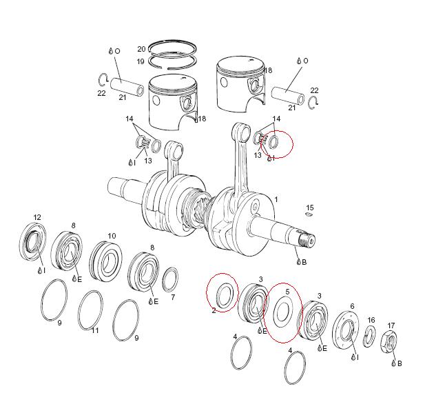

Loks like it did some bouncing on top of the cylinder there.
Inside the crank perhaps one of these spacers or clips came loose? see image
Other something injested by the motor via the carbs.

I think this next week we goint to take apart the crank case to see what we find. But its look like that part thats goes in the Crankshaft.

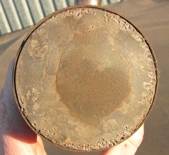

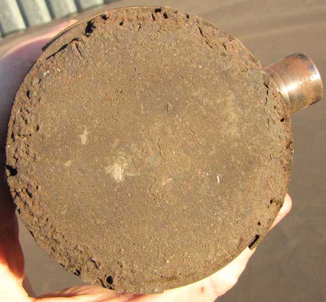

Just for infos sake.

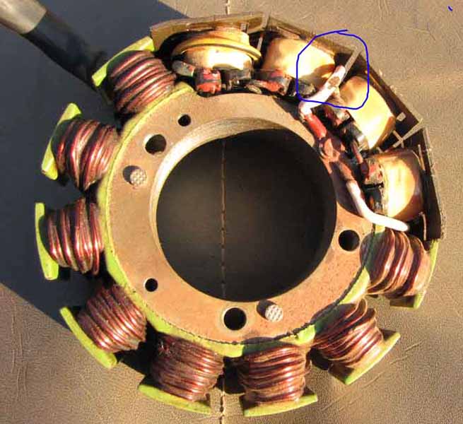

618 at Rhino that also lost power, fortunately on take off, so the plane couldn't get in the air. On inspection this is what we found.
and the culprit
The other piston took a lot more hammering.
My guess would be, in the 582, if something bounced on the piston the whole crown would be full of markings, and not just on the sides.
On the 618 the pistons and coil were replaced, and she is happy again.

Postby Stephan van Tonder » Wed Jul 22, 2009 11:02 am
Low level - My opinion here - yes the issue with the coil is what casued your power loss that day. The damage to the pistons wasn't. Whatever went through there did so quite a while before the coil stopped it short. Those marks were there for a long time as they are all carboned up already - they are not new markings. Also whatever came off in the coil bits cannot end up inside the pistons. So the damage inside was caused by something else.
