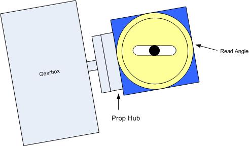

Re: PROP PITCH
oh yes, and the other thing is first measure what angle the prop is at when installed on the plane. Simply take the protractor and place it agains the prop hub, rotate the inner circle until the spirit level is in the middle and read off that degree setting. Then add or subtract the starting degree from that to increase the pitch
- Prop hub angle.jpg (14.25 KiB) Viewed 1736 times
- protractor.JPG (8.94 KiB) Viewed 1735 times
