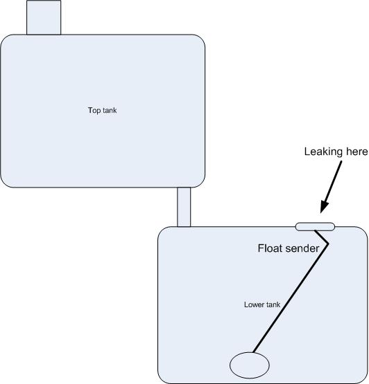

I own a Shadow and have had endless problems with a fuel float switch leaking at the flange and the centre pin. will this "Dragon snot" work in this area?

Sorry, battled to attach a picture. I'm not a computer geek. Its a regular car type float sendor. The problem is that the craft has a top tank that feeds a bottom tank and the sendor is on the side of the bottom tank. the fuel eventually stars to seep through all the areas where there bolts with thread.

Got it,
I reckon this stuff will probably work. Take the lower tank out, degrease with MEK or Acetone, especially around the sender unit. Pour some of this stuff in and lay the tank with the sender flange at the bottom, i.e. the stuff will dry and seal around the threads. Maybe do a few doses to get it nice and thick. It forms a flexible rubbery layer. I know some guys slightly (very slightly) pressurise the tank and force the sealer into cracks and threads. Keep it away from the working components of the resitive float mechanism.

Ok! S you a boffin with the computer. Almost perfect. The sendor mount is on the side, not on top. I was looking for something fuel resistant that i could use like a gasket maker. No one seems to have a product that is fuel resistant. I could make a new back plate with a gasget between, but without a fuel resistant sealant i'll always have the same problem. I live in Pinetown and fly out of Light Flight, Coto Ridge which is just outside Pietermaritzburg. Where are you? By the way, you don't know of a Streak Shadow out there suitable for restoration?

They normally use gaskets made out of cork for fuel level senders. Once you have made a gasket and redone it, there is no harm making doubly sure and using this stuff as well
