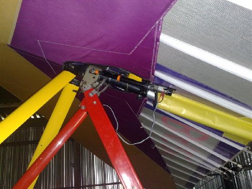

Saw this recently on a trike - electric system.

Re: Inflight electric trim op trike
That looks simmilar to Aerotrike's system.
